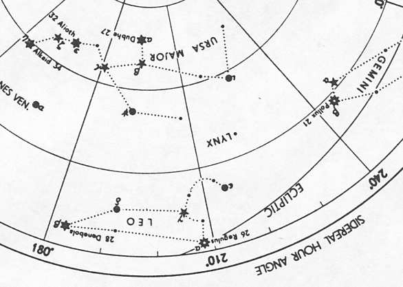

  3. Study for a moment how the SHA labels correspond to the right ascension labels in the pictures below. (Sidereal Hour Angle is the angular distance of a star west of Aries on the star globe. Right Ascension is the hourly distance of a star east of Aries. Navigators use the former, astronomers the latter. See discussion in the Star Finder Book.)

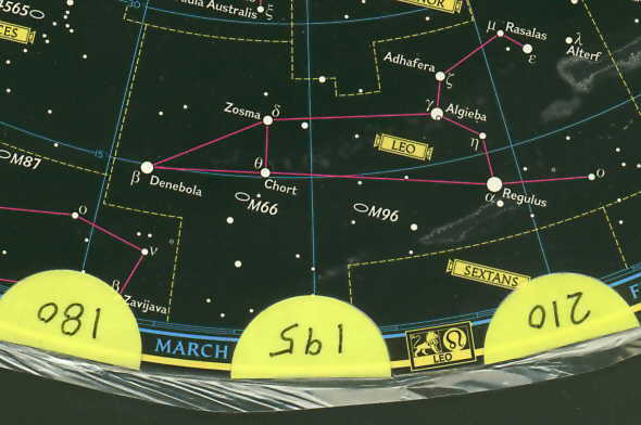

  4. Put one of the yellow stickers (provided) over each of the right ascension hour labels as shown and label each side of the map with the SHA.

section of the map showing SHA labels

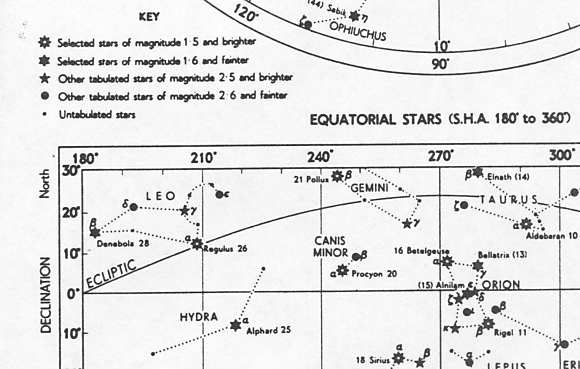

Below is what the corresponding map section looks like in the Nautical Almanac maps.
