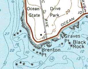

More on the accuracy listed in Table 1. When sighting from land, we need to be sure that they were not looking toward some distant shoreline in which case a "dip short" correction might be needed, but this is unlikely if right at the tip of Brenton Pt. We also need to know the temperature and pressure just to be sure there are no extreme values at hand (which could be another few tenths), and, of course, we need to see the actual sight data. We need to see all the sights, not just the "best" one. And since we are dealing with just one set of sights as opposed to a triad of sights we need to have very specific description of the index error measurements and data. It could well be that Table 1 is just a comparison of their errors in index errors!
