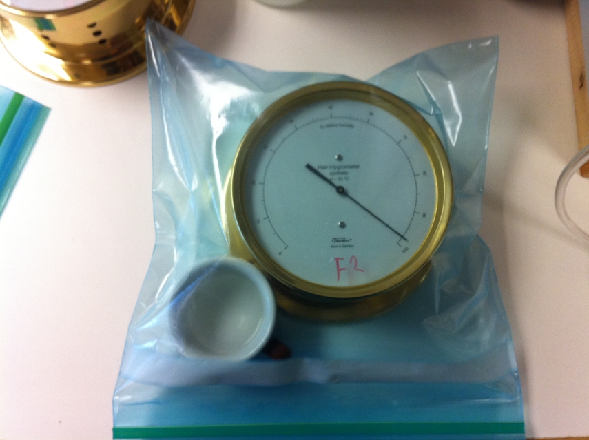

Hair hygrometers, synthetic or real, need to be periodically rejuvenated at high humidity. An easy way to do this is to place the instrument inside a sealed plastic bag with a small open container of water as shown below. Let it sit over night. The instrument should then read about 96% (94 to 98). This rejuvenates the fibers and provides a rough high-end calibration point on the instrument. If you note that it reads below 96, then consider the difference as the offset of the instrument and apply this correction to readings at lower RH values. This method, however, is not a very accurate calibration point because the result you get in a bag like this will depend on the room temperature to some degree.
Some instruments like the Fischer have an adjustment screw available to apply an offset. Remove the instrument from the bag and wait several hours till the instrument comes back to stable ambient RH reading before making the adjustment. If it read 88% at saturation, then it is nominally 8% low, so if the ambient RH read 45% it should be increased to as close to 45+8 = 53 as possible.
Below is a Fischer instrument in a plastic bag with a demitasse half filled with distilled water after setting all night. It reads 98% RH.
