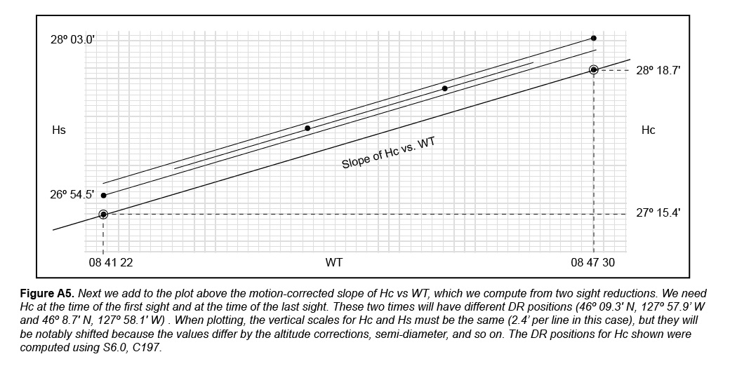

Page 101, Wrong Hc labels on Figure A5
Figure A5 shows those four sights, plus two more, the calculated heights (Hc) at the time of the first and last sights. They are the ones incorrectly labeled. Apparently we grabbed the formatted value for the first sight in A4 and pasted that in place twice, with the intention of changing the numbers to the right values later on.
The missing values are Hc of the sun at 15 41 22 UTC, 7/5/82 from 46° 09.3'N, 127° 57.9'W (the DR position at 15 41 22) and 15 47 30 UTC from 46° 8.7'N, 127° 58.1'W (the DR at 15 47 30). The values are 27° 15.4' and 28° 18.7', which should be the two labels replacing the repeated labels of 26° 54.5'. The slope is then 63.3'/6.1m = 10.4'/1m. The vertical scale is 2.4' per interval.
Thanks to Amazon reader Narley for pointing this out.
Here is the new Figure A5 that incorporates these changes.
