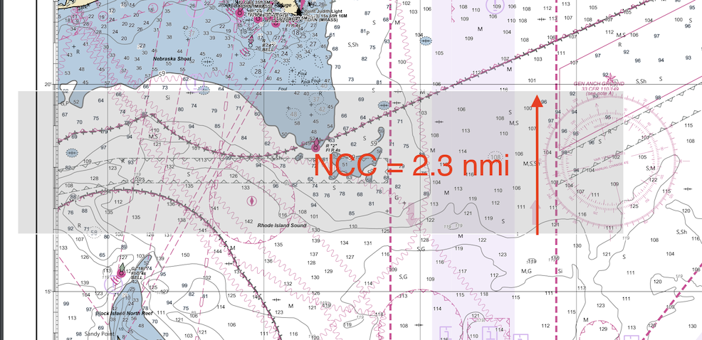

• First pass at at 18465TR -- Missing Canadian ENC section around Victoria filled in with the 18465tr paper data.

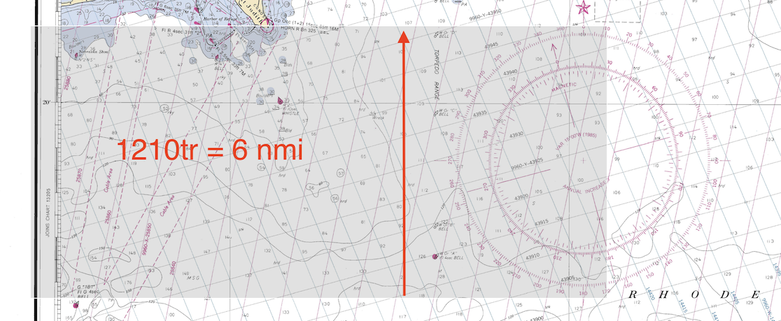

• 1210TR counterpart with V3 in progress.

— According to multiple tests so far, compass roses could be bigger. We need more of a study to figure how much, but +20 to 30% is likely the answer, ie x 1.2 to 1.3 in size. This will likely be fixed when feedback is gathered.
