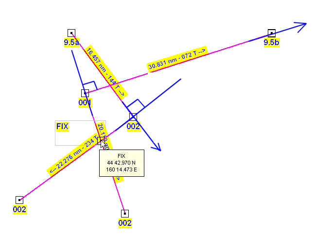

I was surprized to see that there is no solution given for the fix, just the LOPs. So here it is, done by electronic plotting. (The precise answer is 44° 43.0'N, 160° 14.4'E, that we get from our LOP plotting program).
We did this this way:
place two marks on a world chart, and give one the location of the first AP (9.5a) and the other one the location of 9.5b assumed position, and lock their positions. This immediately hides them as it moves them off to the right location.
Then from the chart table menu ask the program to center on one of them. Use a route or range and bearing tool to mark in the azimuth line at the right distance off, and then turn 90° to lay out the LOP. Same with the other one. Then where they intersect we drop another mark, and read off its lat and lon.
Then we captured the screen with a graphics program and filled in the lines (blue lines) to make it look a bit more like a real cel nav plot.
