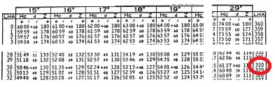

I missed the rule on calc. of LHA. If negative, add 360, and in example getting 330. Then as I go to the table it lists numbers progress through about 99-115 degrees, then truncates. Problem answer in the book uses Hc that would correlate to using 30 degrees. Is there a rule that tells me what LHA to look up when the calc value is 330? ThankQ

I am not sure i follow the question exactly, but it makes me think of one we often do get. Namely, that when you enter any set of sight reduction tables you need to look on both sides of the page for the LHA you care about. Entries like 330 and 30 will be on the same line, labeled one way on one side and the other way on the other side.
If that is not the point at hand, please give us a specific example to work on. thanks.

"when you enter any set of sight reduction tables you need to look on both sides of the page for the LHA you care about. Entries like 330 and 30 will be on the same line"
I *love* this forum. I worked through the exercises in chapter 5 today, and 5.3 #4 threw me for a loop because I couldn't find a row in the table for LHA=330.
Quick search here and the mystery was solved. I *never* would have thought to look for another column of LHAs on the right side of the page.
Thank you!
