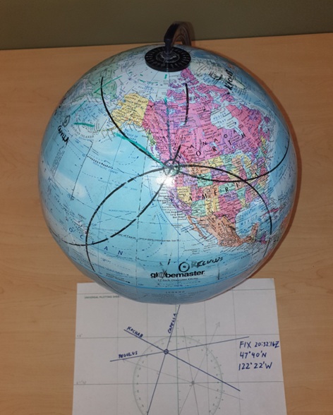

Let me pursue this a bit more, to emphasize that you do not need any DR at all in principle for celestial fix.
A sight gives us Ho, and 90-Ho is z, the zenith distance, which is the distance between us and the GP. We are located somewhere on that circle of position of radius z with center at the GP.
The GP is located at GHA and dec at the time of the sight. Thus we have for each sight we take, of any body, Ho, dec, and GHA.
With two sights we have two such circles and we are located at one of the two intersections of those two circles of position.
You are not necessarily going to do a fix this way, but if you wanted to, you could. Go to our online app at
https://www.starpath.com/calc/van_allen2.html
Enter that data and compute the two intersections, one of which is your fix.
It is always easy to determine which is right. The air temperature alone might do it, as they could be far apart! Even different hemispheres. Or just recall which direction you were looking when you did either of the sights, and then picture looking in that direction from each of the solutions.
