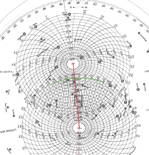

The initial examples were for distances less than 5400 nmi (90º) so they were easy. The blue templates cover 90º. We can do longer distances but it is a bit more work.
For example, going (by airline) from NYC (40.7, -74.0) to Hong Kong ( 22.2, 114.3). The Lon difference is 171.7 headed west, or 188.3 headed east, essentially on opposite sides of the earth, meaning GC route is up over the pole.
Start by setting up as explained leaving from NYC, and then draw in the meridian at the Lon difference and use the red template to mark the lat of HK, as shown.
Then place the 45N template centered on NYC and draw a short border where you run out of blue disk as shown, and mark the the approximate heading intervals in the directon of HK. Then move the template to the HK side as if you were gong HK to NY, and from this you can then figure either direction and the distance.
The distance will be about 90º on the NYC side and about 26º or 27º on the HK side for a total distance of 116 x 60 = 6960 to 117 x60 = 7020 and the initial heading will be about 350 from NYC or 007 from HK.
The actual answer is 7002 at 351.

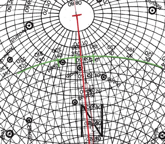

Here is a closer view of the action area.
This is showing a straight line for the headings, but when you do it and follow the curves is is closer to 350.
