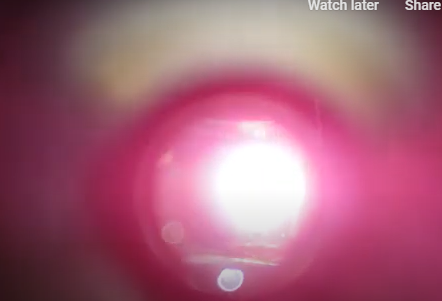

I wanted to get some thoughts around what brightness to expect doing sun sights with a Mark 15.
Even with all index shades down, I find the brightness to be too much and I am worried about eye injury.
This is a second-hand sextant, genuine Davis instrument with no appearant modifications.
I have the same issues as has been documented on this page (screenshot of the video attached)
https://www.cruisersforum.com/forums/f121/davis-mark-15-sextant-is-this-normal-218577-2.html
The user who posted this had the same experience on his first and replacement Mark 15 after returning it because of the same issue.
The brightness is acceptable on the left side with the secondary reflection on the horizon glass.
At this point I am thinking of rigging a Baadar filter on one of the index shades to at least get some practice out of it.
Curious to hear abour your experiences about the Mark 15 and the brightness of sun sights,
Thanks!

As for your main point, if the existing shades are all in place and you are not seeing around any edge of them, then chances of eye injury are small... but with that said, your picture looks much brighter than i might guess, and indeed if you have the impression of over brightness, then you are rightfully concerned.
Let's see what we can tell when we learn more.

I just re-read the forum link you sent and looked at your image, which leads me to ask if you might have been looking toward the sun in that picture?
As opposed to looking toward the horizon and viewing the reflected view of the sun?
That difference can be night and day! The stock filters are not adequate for looking direct at the sun... We only look that way during the solar index method and that requires the Baadar filter PLUS the extra cardboard shade we describe in the book that prevents you from seeing around the edges.
Looking toward the sun it is *very easy* to have light get around the edge of a filter.
The video in that forum post is showing a sun that is getting around the edge of the shades. You can see it happen as the orientation changes just a bit.
It could be they were not in place, or something was misaligned or the scope removed?
