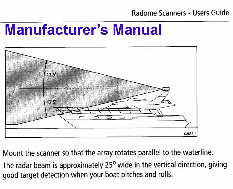

Dave – I’m installing a new 24 inch 4kw radome, and my two goals are preventing human irradiation and avoiding structural interference. (I understand and am not concerned with the range as limited by the height above water.) Chapter 7, Figure 7-20 shows the near-field beam dimensions approximately equal to the antenna itself, with vertical dispersion occurring in the far-field. Photos of my existing system were taken from ashore at bridge level to maintain realistic perspective. My existing radome is 3 feet aft of, and essentially level with the metal canvas framework (structural interference), and is inches above the operator’s head (irradiation concern). My manufacturer’s installation guide demands a very conservative installation compared to your figure 7-20. I attached the manufacturer’s illustration showing transmission through 25 degrees vertical. I inscribed 25 degree transmission lines on my side-view photo. I’d need quite a high tower for a beam transmitted on the lower 12.5 degree line to clear the personnel on the bridge. (Their boat show rep suggested two to three feet clearance above the operator to the 12.5 deg line.) To be safe how high does my new radar need to be above the operator’s body given my dimensions? Dave, if you operated this boat from the upper helm, where would you want the radome? Let me thank you in advance for your very comprehensive and well-written text and this forum. Randy Allen - Olympia, Wa

Your pictures are posted which helps a lot. it does seem that the present level may be a bit low as is, if this pic is to scale. Your manufacturer suggestion is the standard one in use, though chances are the beam remains more focused for some time after leaving the antenna.
I should point out however that we do not have any actual installation proposals in the book. there are some schematic illustrations of installations showing estimated beam distribution, but none is an actual installation recommendation nor is any to scale. It could well be that the smaller the antenna the shorter the near field transition which brings some intensity lower than shown schematically relative to some arbitrary boat length.

The photo of the radome's inner workings are from my new Raymarine RD424 (24” 4kw) radome. (Not sure if you're sensitive to posting specific manufacturers.) Are the 25 degree reflectors only effective in receiving, not transmitting? Do they simply provide more gathering power (and allow for boat pitch)?

The shields on the antenna are for limiting the vertical range of transmission. The reflected return beam is essentially a vertical wall of signal. I do not believe the antenna focusses any of the returned signal that it is catching.
