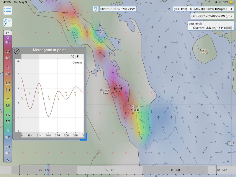

Luckgrib with OFS looks like a great resource for predicting currents however I am confused by the absence of slack water. When you look at the meteogram for a given point, the current never seems to get to zero. Is that possible? Am I reading this wrong? See attached image for example of meteogram off point off Campbell River near Seymore Narrows.

There are new sources. You can read about them at www.luckgrib.com/models look into OFS for current data, WC and SS regions.
If you care to reactivate your web card we can carry on with more questions and details in the marine weather course. If you use Navionics, it would be best to test every thing you depend on, both currents and charts! OpenCPN has a cheap set of official CND charts for the region. You can compare OFS and harmonics using qtVlm. we have a video on that. I think i have a blog post on navigation of the R2AK.
