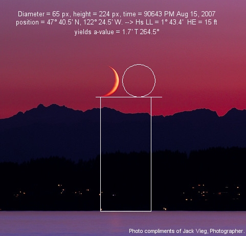

posted August 17, 2007 01:14 PM
Here is the analysis of the good photo from Jack Vieg (this is a 6-second exposure, and just a snippet of a beautiful phtograph showing the Olympic Mountains viewed to the west across Puget Sound from Seattle). The cel nav results speak for themselves.
So it seems the answer is if you get a good photo and the body is low — let's say within 5° of the horizon — then chances are you will get a good LOP.
