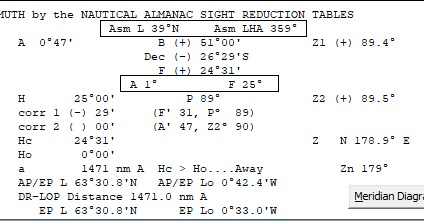

Would anyone have any input on NAO discrepancy when compared to Pub 249 sight reduction methods using the data in this work form? Note: the corrections for Dip, IE, and Ha were omitted as the Hs here was obtained from the Stellarium App. None the less, the reductions should workout similar with the given data. Racking my brain trying to find out why. Any help is much appreciated.

I apologize, compressed photo in above post did not show. So we are looking at a DR 39 21.8’ N, -119 45.7 W. GMT 19h36m02s on December 2nd 2020. Sight Antares Hs 24 09.0’. GHA 118 26.8’ a-Lon -119 26.8 W, LHA-359, Dec S 26 28.5’, a-Lat-39N. Pub 249 yields Hc 24 31.0 yet NAO yields an Hc 26 28.0’ a difference of 117’?

Here is the data as i see it for the sight reduction:
For this data Hc = 24º 31.1', Zn = 179.0
see
https://www.starpath.com/calc/Celestial%20Navigation/srt1-2.html
so it looks like there is some error in the NAO form. Please see if you can find a PC and then run the NAO check in celestial tools so you can find your error. Or start from scratch on a blank form and do it again, rather than look for errors in one already filled out.
 - posted December 02, 2020 08:48 PM      Profile for David Burch           Edit/Delete Post
Actually we will just do this. Here is the answer from CelestialTools: NAO gets 24º 31' with Zn = 179, which is the same.
We strongly recommend, tracking down a PC and using CelestialTools to find sight reduction errors. Use www.starpath.com/calc to find out what is the right answer to use as the reference, as done here.

Thank you kindly, that was a great help. I was able to locate a small rounding error with Dec effecting F. I do appreciate the assistance and your time.
