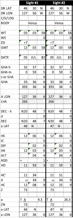

 - posted April 03, 2020 09:44 AM      Profile for Ian           Edit/Delete Post
I created a form like the USN 3530/1 to compare the reduction for using 46N and 47N. I will plot and take a photo of that, too

Ian
 - posted April 03, 2020 04:09 PM      Profile for Ian           Edit/Delete Post
Well...it turns out, it does NOT make a difference. I guess I just had to map it out. My previous effort did not result in such an accurate fix (here is was 45 53N and 128 06W)

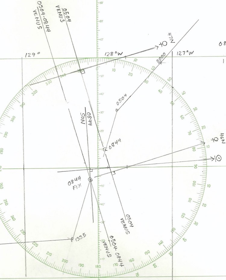

 - posted April 09, 2020 04:06 PM      Profile for Ian           Edit/Delete Post
Here's the plot with the azimuth for both the 47N and 46N a LATs plotted. As you can see, they are the same line! This is also a practical example of how the LOP (for a remote enough GP) does approximate a straight line.

 - posted April 09, 2020 06:34 PM      Profile for David Burch           Edit/Delete Post
Is this a problem from HBS? and if so, which problem and which sights? Thanks
