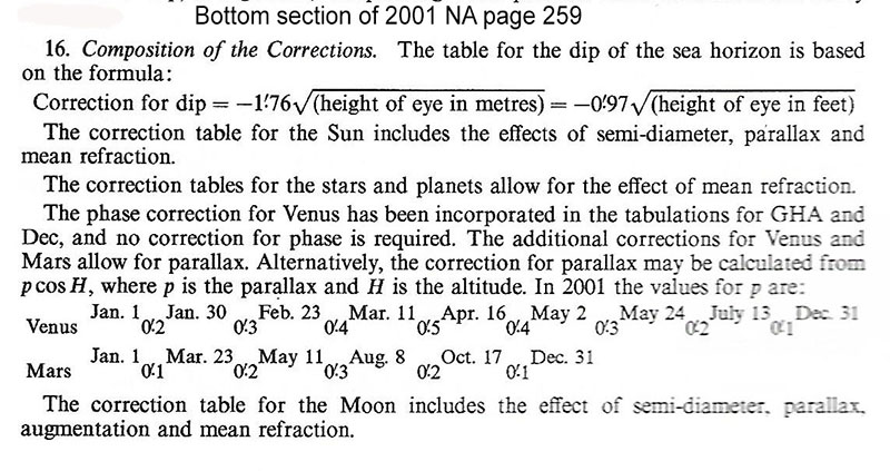

I am getting to learn with Stark Tables. I don't know what is page 259 in the Nautical Almanac. I think they mentioned a version that I don't have. What is this p-value? Can I obtain the particular information, which should be at page 259, from the StarPilot-PC software program? Do they mention HP for Venus or Mars? Because in my .pdf almanac which I have, is HP for Venus and Mars is given every 3 days.

I have attached an image of the bottom of page 259 from the 2001 NA referred to on page -x- of the Stark Tables book. As you can see 'p' is the parallax of Venus and Mars, which is dependent on the year and month of the year. 'p' is an additional correction applied when doing a Sight Reduction.
Page 259 has the same information in every issue of the Nautical Almanac. The only difference is that the data for the 'p' for Venus and Mars is updated for the given year.

Thank you for making this clear. I did not see clear what they mentioned with the term "p". Now I see that they indicated with "p" the term H.P. I use a formula for the sight reduction calculation P = HP cos(Ha). Now I see that "p" is NOT P; "p" is H.P. That is why I was confused.
