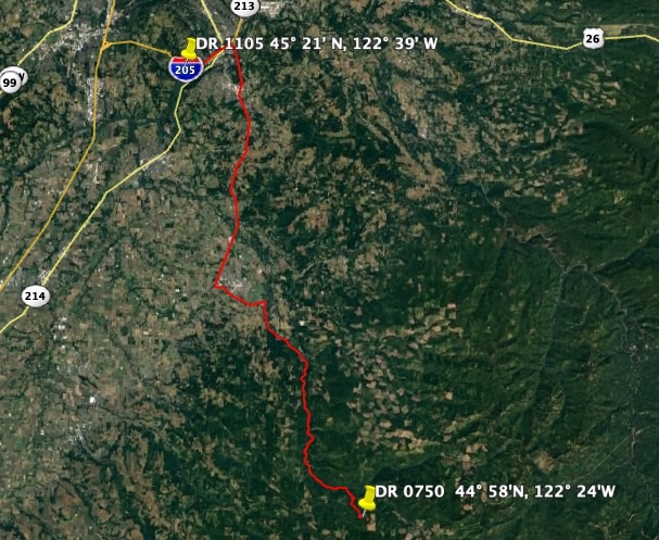

It appears that the DR coordinates for the moon and sun fixes are in the Oregon Cascades: https://www.google.com/maps/place/44°58'00.0%22N+122°24'00.0%22W/@44.8447378,-122.9098458,9.73z/data=!4m5!3m4!1s0x0:0x0!8m2!3d44.9666667!4d-122.4
I'm working the problem like I'm not several thousand feet underneath rock, but maybe I'm mistaken?

Thanks very much for pointing this out. It is in the errata now.
This is one of the beauties of celestial navigation. It can be done on land or sea. Famous documented examples are from Lewis and Clark, Perry at the North Pole, and Morton Stanley's 700-mile search for Dr Livingston in Africa. Starpath served as a consultant on the navigation of that venture shown on the History Channel.
You can think of this Moon-Sun running fix from chapter 9 as carried out in a Toyota Land Cruiser using a bubble sextant as an artificial horizon. To see the actual track this expedition might have followed download this kml file and drop it on Google earth, and then zoom in. (I believe this requires Google Earth Desktop. It seems they removed this option from Google Earth Web.)
But with that said, this should have been noted as a hypothetical example. The dip correction would have to be adjusted to 0.0 for the bubble data and the HE does not matter. I will see if we can rewrite that to cover these matters... and make an errata. In short, the data are just fine and the location is no problem, but the dip should not be there.
Thanks again. For now, just pretend this was all water.
