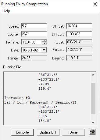

The logbook entries I'm using are directly from HBS page 9, with fixes or DR positions inserted between the log entry and the course entry) 25 9 2159 992 N37° 06.4' W132° 32.1' 197 5.7 26 10 0000 1003 N36° 55.9' W132° 36.1' 197 5.7 27 10 0500 1032 N36° 28.2 W132° 46.6' 276 5.7 28 10 1334 1082 N36° 33.4' W133° 48.2' 210 4.8
The 2159 entry gives the fix, calculated using SPPC and is very close to the answer given in HBS. All other positions are my DR positions, calculated using SPPC via the log and heading method. In each DR calculation, I entered the speed and course shown in the logbook at the start of the leg and the succeeding log entry. I recorded the DR position in my logbook and then clicked on 'Update'.
I prefer not to use auto update because I want to be able to compare the current DR position with the newly calculated position for a reality check. Once I was satisfied that the answers passed my reality checks, I clicked on 'Update' and the calculated positions appeared in the current DR position boxes in the dialog as expected.
After the 3 dr steps to 1334, I had my dr position at 1334 recorded in my logbook, but the DR position in the settings dialog was unchanged from the 2159 position. I had to copy the 1334 position back from my logbook into the settings dialog. It would be convenient if the new DR position replaced the old DR position in the settings, not just in the F8/Update DR dialog - but I accept that it may not be the designed program behaviour.
I attach the fix using calculation. As you can see, I've used the course and speed from the 0500 logbook entry, so my fix doesn't match the answer in HBS. If I use C263, S4.5 as per the answer on page 29, I get:
N 036°22.9' W 133°17.9'
That's almost exactly as per the book. I would expect a slight difference because I checked all the sights from 10:55;29 to 13:34:46 using the sight analyzer and kept them all because I thought they were all good. Oddly, if I eliminate all but the 11:02:02 and 13:34"46 sights selected in the book, still using C264 S4.5, I get: N 36°23.4' W 133°16.6',
HBS gives this position on page 29:
N36° 22.9' W133°17.8'

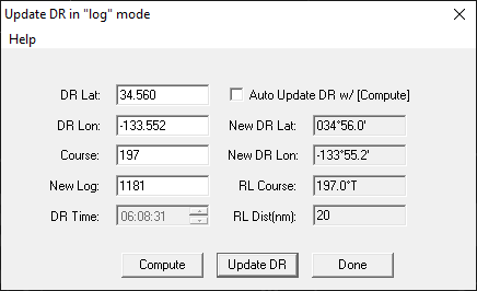

After I click on Update, this is what I see, the expected values are now in the DR.

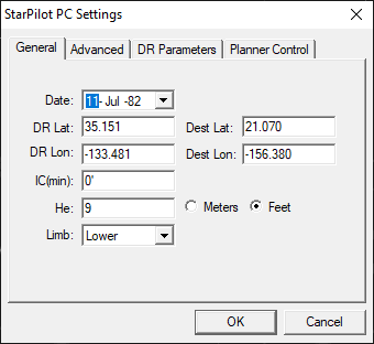

Lance
posted March 17, 2021 06:59 PM
But when I close the DR dialog, even though I clicked on Update and the DR position is updated in the DR dialog, the old DR persists in the Settings dialog, the DR before I updated the DR, which of course is carried into the default DR for the fix. If I do a set of, say three, DR updates, everything looks fine in the DR dialog, but the underlying stored DR, seen in the settings dialog, is not updated. This may be intentional, depending on how you want the program to work, but I think I would prefer the DR update to carry through to the settings and hence the celestial fix dialogs, rather than have to update them manually. When I reopen the DR Update dialog, the old DR is still there, of course - unless I manually update the DR in the Settings dialog.

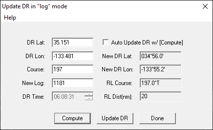

Hi, again. Thank you for the videos. I watched the one on updating DR in "log" mode using "Auto Update" and I get the results expected if I follow that procedure.
The problem I mentioned arises if the Auto Update box is not checked. Apparently the "Update DR" button only copies the New DR lat and lon text into the top left text boxes but doesn't update the DR position.
You can see this in the attached images. If I:
(1) clear the auto update box and click on "Compute" (top panel of attached image) ...
(2) click on "Update DR", (middle panel) ...
(3) close the DR dialog and open the settings dialog (bottom panel)...
I find that the new DR position has not been saved. My workaround is to write down the new DR positions and manually update the settings dialog ready for the next fix.

Lance
posted March 24, 2021 07:21 PM
Yes, that's right. If I do a set of sights and get a fix, then click on 'Update DR', the new fix is transferred to the DR in the Settings dialog, as expected, where it is available for more DR or more fixes.
In the "Update DR" dialog in log mode, the computer only updates the DR position and the log if "Auto Update w [compute]" is checked, regardless of whether or not I click on "Update DR".
A workaround is to check "Auto Update w [compute]" and click on "Compute" a second time. It then updates both the DR position and the log, as you can see in the settings dialog.
If I had a choice, I would like the DR dialogue to update the DR position and log when I click on "Update DR", but the workaround will work for me as long as I remember it.
