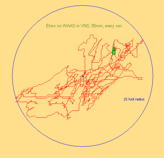

One way to evaluate the accuracy or reproducibility of a GPS unit is to plug it into an e-chart program and simply let it run overnight. Then zoom in and look at the distribution of the track points that have accumulated. You can set a mark in the middle of the distribution, and put a range ring on that to see put a scale on the picture. A sample is shown below.

This picture was accumulated in nobeltec VNS using a garmin etrex for 90 minutes, recording a position every 1 second.
