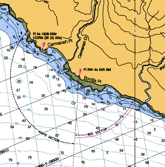

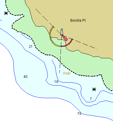

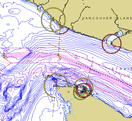

 - posted April 11, 2006 09:31 AM      Profile for David Burch           Edit/Delete Post
Here is another example from the west caost of Vancouver island, just at the entrance to the Str. of Juan deFuca.
Here is what the vector chart data had available on this light with a right click:
Lighthouse
Aid number: G5289
Shown 1/6-7/12
Sector Light:
FlR 4.0s 56ft 8M 292.0°-3.0°
FlW 4.0s 56ft 8M 3.0°-135.0°
We have to forgive them for writing 3.0° when they should have written 003.0°. This is a commercial version of vcector charts. I would hope the official ECDIS had this right.
Below is the NOAA chart symbol.
We leave it up to the reader to find in the Canadian Light List (online) the description of this light and to post it here. Maybe that will state what the sector marks. It looks like it marks the corner of Cape Flattery! and the mid channel buoy "JA" of the VTS system.
In other words, if you were traveling west along the Canadian coast and wanted to head south offshore, and it was foggy, you should not turn left while that light is still red.
We look forward to the Canadian LL description of this light.

 - posted April 11, 2006 06:37 PM      Profile for Dan Cline           Edit/Delete Post
Here is the description from the Canadian Light list. The red sector lies east of a line from Bonilla Point to Tatoosh Island:

 - posted April 12, 2006 02:46 PM      Profile for David Burch           Edit/Delete Post
thanks for that. so we see the sector light is essentially marking a line of position for entering or leaving the point-to-point entrance to the Strait. Often the sectors are used to mark hazards, but this does not seem to be so in this case.
prior to about 1998, the tatoosh island light had a red sector marking the two rocks called Duncan and Duntz, but this sector marking has since been discontinued... i went immediately for that example and then discovered it was gone.... it was always a rather weak demarcation, meaning you saw both colors for some distance, so maybe it was decided that this was less safe than not having any at all?
