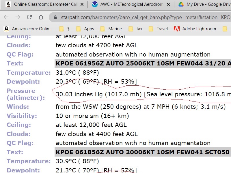

1. how is it possible to have on a METAR to have SLP that is lower then the pressure altitude for the same station?

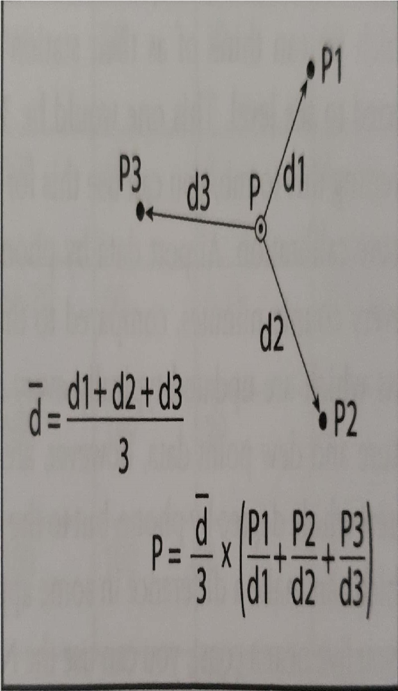

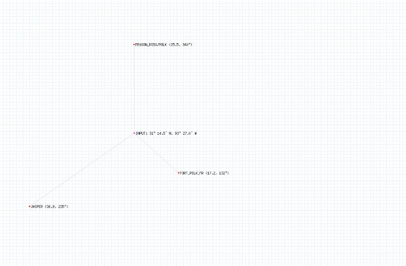

2. using the math equation in the Barometer Handbook (p.67) for 3 station points I end up with an answer that doesnt not make sense to me. I have gone thru it couple of times with the answers all ending up the same. The result is around 100 points higher then I would guess by just looking at it. I have provided the plot that I am using for the equation. The additional information need to complete the problem;
P1 = 1013.5 d1 = 25.5
P2 = 1013.8 d2 = 17.2
P3 = 1013.5 d3 = 36.9
The result that I keep getting is 1114.1

The first is tied to the average outdoor air temp over past 12h, plus local lapse rate... We need to see all the data related in the unusual case you cite. To interpret the metar you see, you have to go back and also get the data from 12h earlier. Maybe this will do it: https://www.weather.gov/tsa/obs

This image is from the starpath link to metars. I am a bit confused because the SLP show less then the pressure altitudes.

I understand the idea behind the time correction. This has to do with the equation that is provided in the book as shown in the attached image. the data for the equation is in the first post (pressure and distance of location 1-3). It is possible that i am doing the work wrong but as I see the 3 location average equation is giving me an answer much greater the all of the 3 pressures. indicating to me that the answer is incorrect.

Regarding the metar post above: we also need to see the one that is 12h earlier than that one.

1. METAR - a column of air is heavist at the bottom, not part way up at pressure altitude.
2. I understand the finding of interpolated time. The equation as no variable for time (T), just pressure and distance away from current location, so it is not important in solving for P. Assume the numbers I provided are accounting for time. As I stated before after running the equation numerous times i ended up with a value larger then all the 3 pressures that were used in the equation. That was a red flag to me! Again, regading my question, Time does not matter.

If your position is as shown then you are well positioned to get an accurate pressure... keeping in mind that one of the stations might be in error. We have an article in the blog about how to check the dependability of an airports data.

On the other point: Still need the air temp 12 hr earlier to get the conversion right. That should be explained in the book. We also have an article that proves this small detail is crucial:
http://davidburchnavigation.blogspot.com/2013/10/air-temperature-dependence-of-sea-level.html
