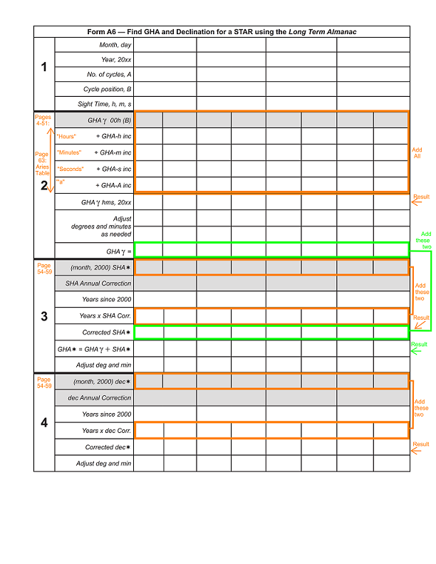

Here's an attempt at simplifying the Kolbe Long Term Almanac form for stars. Apart from adding the missing divider in one rectangle, the columns and rows are identical - I've just added explanatory information to remind me of which rows to add etc. I had to shrink it a lot to fit into the discussion post format, but the original is much easier to read. Hopefully the image will now be uploaded.

With our posted images you can right click the image and then open in new tab and then zoom, which sometimes gives a better view.

If anybody wants the high resolution original with my modifications, I can send it to Starpath for approval. The original is intellectual property of Starpath (excerpted from "Instructions on the use of the Long Term Almanac", Starpath Publications, Seattle WA).
