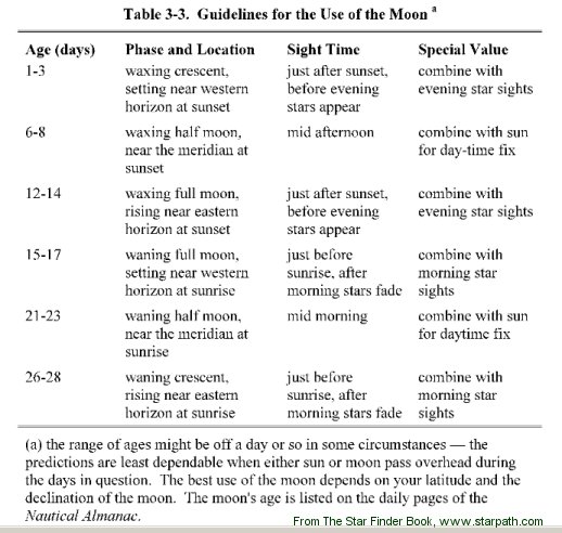

The visibility of these moons is divided between daylight and night about equally. They are especially valuable for routine cel nav, whereas other phases are not as special, as shown in Table 3-3 of The Star Finder Book.
