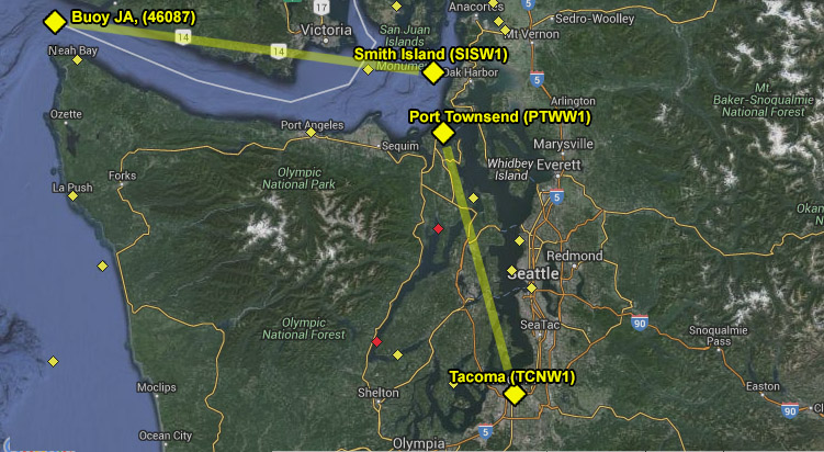

As a rough rule of thumb wind speed in the Strait of Juan de Fuca and Puget Sound is proportional to the pressure difference between their end points, blowing from high pressure end to lower pressure end.
With wind speed in knots and pressure differences in mb,
Approximate wind speed in kts |
Pressure difference in mb |
mid Puget Sound |
~ 10 x |
(Port Townsend - Tacoma) |
mid Strait of Juan de Fuca |
~ 10 x |
(Tatoosh Island - Smith Island) |
* These estimates can be used to anticipate wind strengths that might develop based on recent pressure observations, or this reasoning can tell you which direction calm or light air will fill in from based on recent pressure changes. We need more data, but for now is seems a factor of 10±2 covers most cases.
Again, this is rough guide [see note below], just to keep the pressure effect in perspective. If we see 1 mb difference over about half these distances then it would create ~20 kts per mb difference, and so on.
In the tables below, wind is in m/s. Multiply by about 2 to get kts (or 1.93 is closer).
Pressure differences in Puget Sound (For past 6 hr, every 6 min.) | |
Port Townsend, PTWW1 ( See all ) | Tacoma, TCNW1 ( See all ) |
Pressure differences in Strait of Juan de Fuca (For past 24 hr, every hr.) See neat pressure diference plot from BigWaveDave.ca | |
Buoy JA, 46087 ( See all ) | Smith Island, SISW1 ( See all ) |
