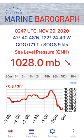

This is the main screen of the app. The top shows the present time and location of the device, along with the course over ground (COG) and speed over ground (SOG) when moving. We determine these values from the GPS data (location services); COG and SOG are discussed further below.
The present pressure is showing in large numbers, followed by a trend indicator. The diagonal down arrow means the pressure is falling. To see a trend icon, there must be pressure data stored for a time that is one hour earlier than the present time. This could be a continuous record, or just an interval of data at that time. Else only a dashed line will show. PRESSURE TREND ARROWS are discussed further below.
The initial screen always shows the 30 minute graph (30m), but in this image the 3-hour (3h) graph has been selected. On the 3h graph we also see the pressure tendency, which is how much the pressure has changed over the past three hours. To see this value, the device must have a full three hours of data stored, else it will show as dashes. See PRESSURE TENDENCY below for more information.
To read the pressure from a specific point, tap that location on the graph. The precision and pressure intervals on the graph are determined by your choice of display precision in the Settings. These can be 0, 1, or 2 decimal places. The pressure and time will appear above as shown and remain until the next update. The graphs can be pinch zoomed to see more detail, or double tap to expand both scales. Use the Reset View in the top right to undo changes. Use the small red arrow at the botom right, or swipe left, to see digital display below.
Use the red arrow or swipe right to return to the graph. This display is made purposefully large so it can be read from a distance when using the app in a dedicated phone as a precision barograph.

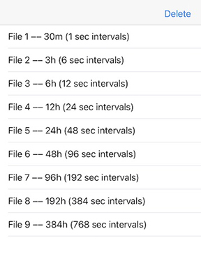

The View Data button takes you to an index of the files storing the data, shown below.
The pressure is read once per second and stored in File 1; every 6s (6 sec) the value is stored in File 2; every 12s in File 3; and so on. The data in these files are what is shown in the graphs. The Delete button here offers the opportunity to delete ALL data in ALL files. A confirmation is required to proceed.

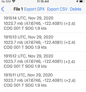

Clicking any one of these files will show the present contents of the file, adhering to time and unit choices made in the settings.
The time format is hhmmss. The pressure stored here is always SLP. If you want station pressure here, set station elevation to 0. The Lat-Lon format is always decimal degrees. COG is always degrees true and SOG is always knots = 1 nautical mile per hour.
The value in ( ) is the sensor offset in mb, discussed below under SETTINGS. This is always in mb because official sources of sea level pressure data will be in mb. We also include just one decimal, as we cannot know the absolute value of the atmospheric pressure any more accurate than that.
The Delete button here is the option to delete just this one data file, without disturbing the others.
The Export CSV link shares all data in this file as a CSV file to other devices by txt, airdrop, or email. This data can then be archived or imported into a spreadsheet program for further analysis of the pressure or navigation data. The format of the CSV file is fixed and independent of other display choices made in the Settings. The time is always UTC; the position is in decimal degrees; pressures are all in mb; station elevations are in feet; sensor offsets are in mb; COG in degrees true; and SOG in knots.
The Export GPX lets you share a track file of all positions and the associated times stored in this file. The GPX file can be imported to a navigation or weather program for analysis and route planning. This file can also be displayed on Google Earth.
