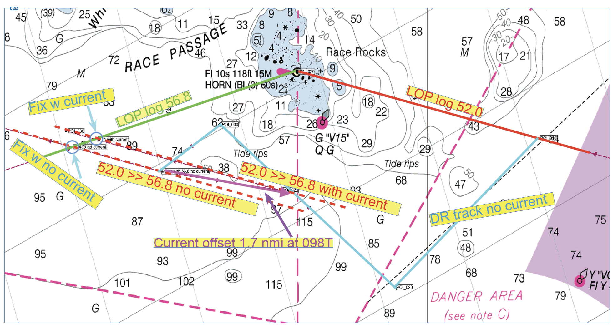

22 New exercise 9-14:
9-14. A running fix with course changes and in a current. Here is the logbook. We are navigating by log and compass, so there is no speed recorded here, but generally that would be included in the logbook. We use 20.0ÂșE for all 18465Tr work.
Time Log Course Notes
1220 52.0 207M Race Rks Light bears 264M. On starbord tack.
1237 53.9 290M Tack to port (turned right)
1257 56.1 215M Tack to starboard (turned left)
1303 56.8 215M Race Rocks Light bears 053M
Part A. Find your position at log 56.8 assuming no current.
Part B. Find position at log 56.8 assuming a current over the full run of 1.7 kts in direction 098T. (Remember courses are M and current is T.)

Part A. No current fix = 48.287,-123.585; Part B. With current fix = 48.288,-123.579       Plot of the solution.
