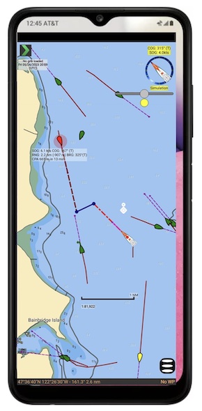

AIS is crucial for collision Avoidance
Free computer nav apps such as OpenCPN or qtVlm, and other commercial apps provide valuable vessel ID and closest point of approach (CPA) data using dAISy signals. Sample below.

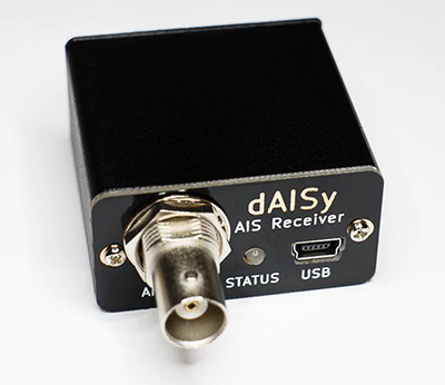

  • Very low power consumption, less than 100mW in receive mode (<20mA at 5V)
  • 38400 baud serial output over USB in industry standard NMEA format (AIVDM)
  • No drivers required for Windows 10, Windows 11, Mac OS X+
  • Robust aluminum enclosure
  • BNC connector for 50 Ohm VHF antenna (antenna not included)
  • Mini-USB connector for data and power (3ft USB cable included)
  • You can monitor the range of signal strengths collected to evaluate different antennas.
  • Made in the USA

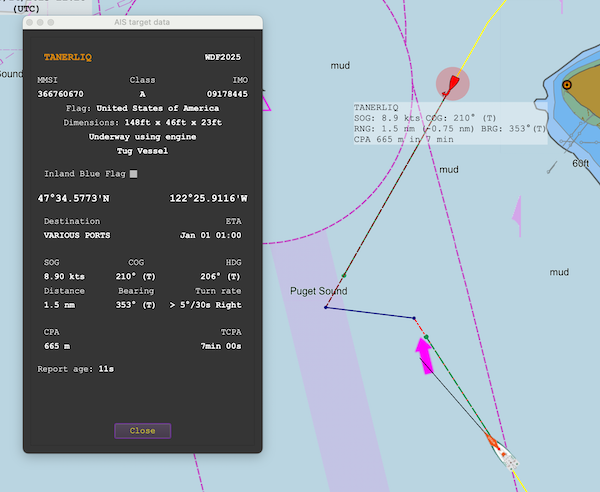

  • CPA display of AIS data in qtVlm. The green dots are where each vessel will be in 6 min. The target is marked red because it has a CPA less than the 0.5 nmi (925m) limit we set. This will occur in 7 minutes, at which time the target will pass on our port bow at a distance of 655m. We see that our vessel is slipping north in a current (COG predictor line to the right of the heading line). At the moment of this picture, the target is 1.5 nmi off in direction 353, heading 210 at 8.9 kts. This target is the 148-ft oceangoing emergency response tug Tanerliq ("tun-ul-lik") — a notable vessel in these waters.

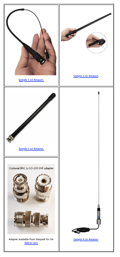

    Check out dAISy antenna options
