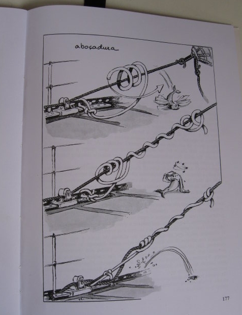

This knot I saw in the Tabarly's book "Guide pratique de manœuvre". Actually I read a translation of this book in Portuguese many years ago and the name, in Portuguese, is "abossadura".
posted December 28, 2009 06:27 PM
Thanks for that. It appears the English version of the book is Practical Yacht Handling and there are many used copies available, so we have ordered one. I am anxious to see this in print. Should have it in 5 days or so. Will post back here what I learn. --david
Ps Google Translate function does not know an English word for "abossadura." Can you tell us what that word might mean in this context.... then we can compare to what the English book calls the knot.... or is it a hitch?
Alberto
posted December 29, 2009 02:09 AM
The word "abossadura" in Portuguese comes from "bossagem" that in its turn comes from "bosse", in french, that means a protrusion in stone or wood. It seams to me that it's an architectural element. In the context: this is a knot used "to tie a new line onto the tensioned part of the line in use and then take up the tension" when we do the knot it seems to be a protrusion in the previous tensioned line. This is my guess. I will try to find the book in Portuguese and take a picture.

I took this picture from a friend's book and how you are going to observe, I discovered that the spelling in Portuguese could be also "aboçadura". Pierre Raffin-Caboisse, the french navigator that's in Rio now in routing for the Pacific ( http://www.babarautourdumonde.fr/index.php?lng=en ) told me that this knot is known in Bretagne by the name of "noeud de bosse". I'm writing this e-mail because I don't know how to post a picture.
Best from and happy new year,
Alberto
posted December 30, 2009 11:54 AM
Thanks very much. The French "noeud de bosse" seems to mean something like "bump knot" which is similar to what you had before.
Note that this is obviously in the same family, but it is not identical. Notice the one i had learned has the initial wraps including the tail, whereas this one does not. Also the final hitch is different.
But they have the same intention. This one is being used to move a block aft without tacking.
Maybe i simply learned it wrong and this is the way it should be? We will have to set up some very heavy loads here to test the two.

We got our copy of Tabarly's Practical Yacht Handling yesterday.
The same picture is in this book, but the name he uses here is "Stopper hitch."
Again, it is not quite the same knot, but coming from this expert, i reckon the one he has is just as good. We will do some tests here and report back.
