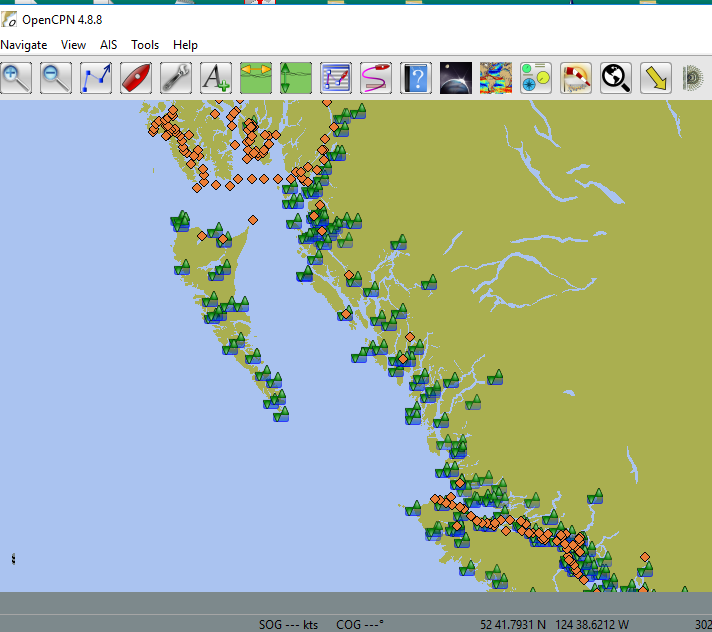

We have very good Atlas north of there on to Ketchikan in our SE Alaska Current Atlas, which is much better than the official tables, and we have resources for the inside of Vancouver Is south of there in a GPX set of current stations. But where you ask about, you are pretty much on your own.... but you can do very well with some resources to help.
namely some CND charts show current arrows (at peak flow) , recalling the flood has feathers, see ie chart 374. But maybe better still you can use OpenCPN (mac or PC) to view all tide and current stations in that region. then click each to see hourly data.
then you have to piece together the flow pattern between these stations based on the tides and currents showing and your own readings.
the Canadian Sailing Directions also have many notes on currents in this region.
Sophisticated programs like Expedition can pull out the actual current you experience based on measured BSP, SOG, Heading and COG. but instruments must be calibrated.
then knowing your actual current compared to estimated flow you have something to go by for planning ahead.
note too that the free program opencpn has a tactics plugin that will also extract current from the sensors mentioned.
In the image below, green icons are tide stations; orange are current stations.
