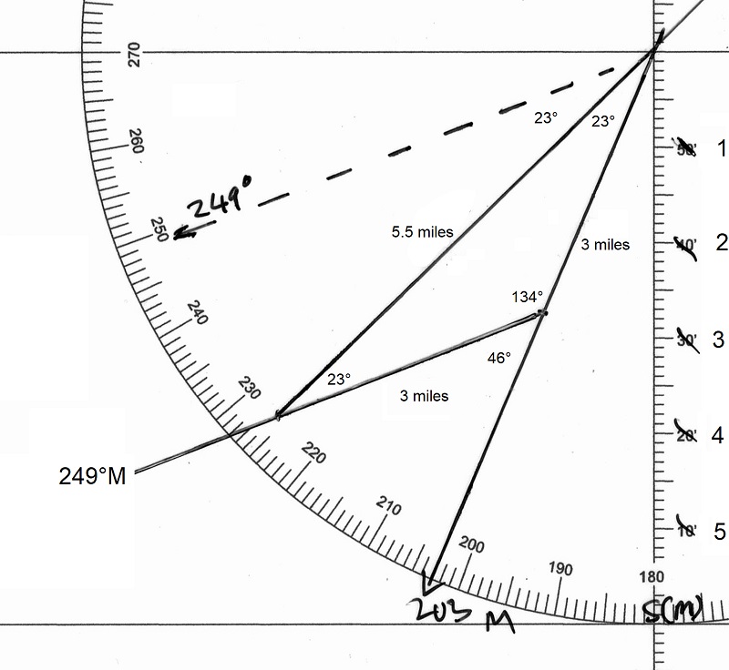

Spinning the wheels on this one, too. I keep getting 046°M as the return heading I plotted the attached diagram in the hope that my previous failure to get 053°M as the return leg was due to my poor plotting on my homebrew chart, but the hoped for 053°M has not materialized. I'm still close to 046°M, as the diagram attached shows. Can anybody see what I'm doing wrong?

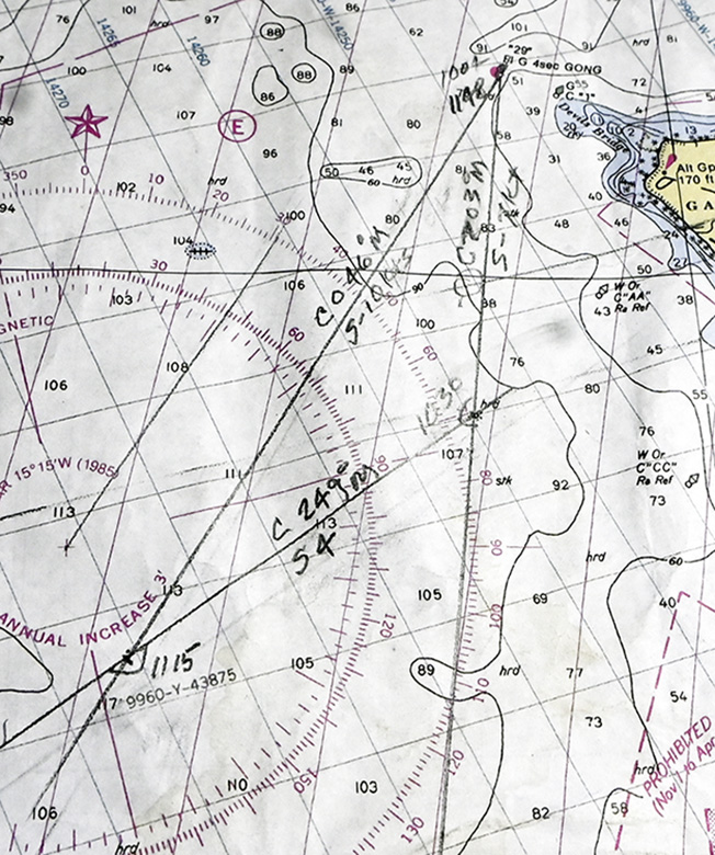

I have plotted ex 5-18 on the 1210TR chart and my answer is C-046° M, arrival time is 1148.

Lance, it appears that you are doing nothing wrong.
