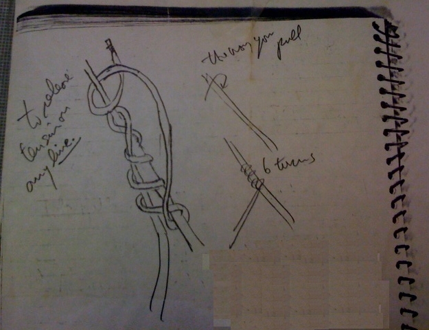

Happy holidays to all. My gift is to share a unique knot that could prove very helpful. It is a way to release tension on a line. The applications i have had (crucial in both cases) was changing winches on a head sail sheet without tacking, and also to clear a jammed winch.
This knot is used to tie a new line onto the tensioned part of the line in use and then take up the tension on the new line till the problem at hand is solved.
I do not know the name of the knot, and have not seen it in books. It is related to a rolling hitch, but that one is not up to holding the head sail of a big boat.
for now, I will just post the picture here (found in an old logbook) and then come back with better instructions.
For practice (most definitely needed before trying this underway!)you might hang a cement block or anything very heavy over the top of a high pipe or rail, then practice using this knot to release tension on the main line holding it.
If anyone knows the name of it, please let us know. It might be related to Ashley's "Safety Belt Hitch"? I have only seen it used on two lines of about the same diameter.
Feedback always appreciated.
more soon on this note.
Note a difference between this one and rolling hitch or safety belt hitch is this one is not meant to slide. These others are designed so you can slide them up the rope and they grip and hold pulling back down, whereas this one is purely to hold the massive load of a sheet under sail.

This knot I saw in the Tabarly's book "Guide pratique de manuvre". Actually I read a translation of this book in Portuguese many years ago and the name, in Portuguese, is "abossadura".

The word "abossadura" in Portuguese comes from "bossagem" that in its turn comes from "bosse", in french, that means a protrusion in stone or wood. It seams to me that it's an architectural element. In the context: this is a knot used "to tie a new line onto the tensioned part of the line in use and then take up the tension" when we do the knot it seems to be a protrusion in the previous tensioned line. This is my guess. I will try to find the book in Portuguese and take a picture.

Thanks very much. The French "noeud de bosse" seems to mean something like "bump knot" which is similar to what you had before.
Note that this is obviously in the same family, but it is not identical. Notice the one i had learned has the initial wraps including the tail, whereas this one does not. Also the final hitch is different.
But they have the same intention. This one is being used to move a block aft without tacking.
Maybe i simply learned it wrong and this is the way it should be? We will have to set up some very heavy loads here to test the two.

Yes, you are all right. They probably belongs to the same family but they are not the same. Maybe variations. Best from, Alberto.

The same picture is in this book, but the name he uses here is "Stopper hitch."
Again, it is not quite the same knot, but coming from this expert, i reckon the one he has is just as good. We will do some tests here and report back.
