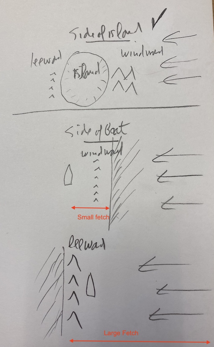

| 123 | 11.1 2nd paragraph. | We refer to shorelines on the leeward side of the boat vs windward side, but this is not as clear as it should be, since it is easily confused with windward side of an island. The intention is as shown in this sketch.
